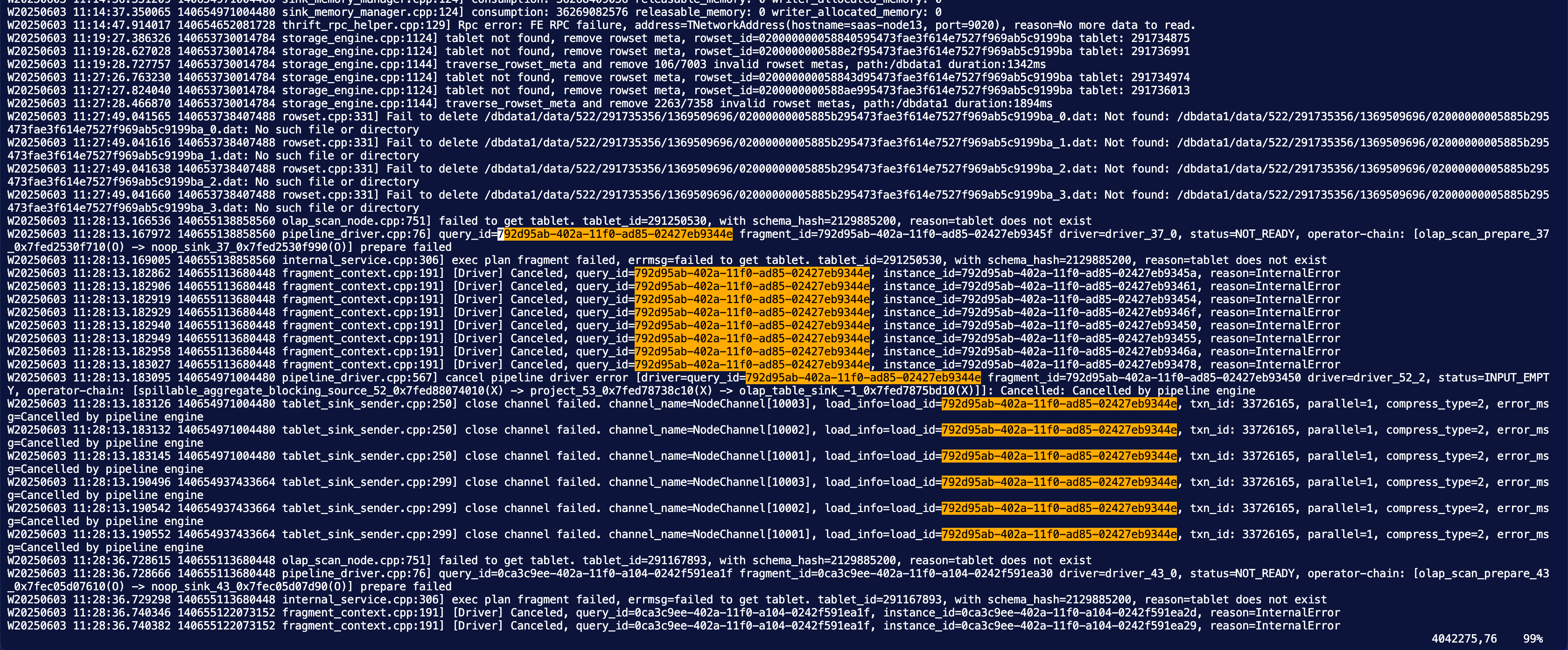

W20250603 11:14:47.914017 140654652081728 thrift_rpc_helper.cpp:129] Rpc error: FE RPC failure, address=TNetworkAddress(hostname=saas-node13, port=9020), reason=No more data to read.
W20250603 11:19:27.386326 140653730014784 storage_engine.cpp:1124] tablet not found, remove rowset meta, rowset_id=020000000058840595473fae3f614e7527f969ab5c9199ba tablet: 291734875
W20250603 11:19:28.627028 140653730014784 storage_engine.cpp:1124] tablet not found, remove rowset meta, rowset_id=0200000000588e2f95473fae3f614e7527f969ab5c9199ba tablet: 291736991
W20250603 11:19:28.727757 140653730014784 storage_engine.cpp:1144] traverse_rowset_meta and remove 106/7003 invalid rowset metas, path:/dbdata1 duration:1342ms
W20250603 11:27:26.763230 140653730014784 storage_engine.cpp:1124] tablet not found, remove rowset meta, rowset_id=020000000058843d95473fae3f614e7527f969ab5c9199ba tablet: 291734974
W20250603 11:27:27.824040 140653730014784 storage_engine.cpp:1124] tablet not found, remove rowset meta, rowset_id=0200000000588ae995473fae3f614e7527f969ab5c9199ba tablet: 291736013
W20250603 11:27:28.466870 140653730014784 storage_engine.cpp:1144] traverse_rowset_meta and remove 2263/7358 invalid rowset metas, path:/dbdata1 duration:1894ms
W20250603 11:27:49.041565 140653738407488 rowset.cpp:331] Fail to delete /dbdata1/data/522/291735356/1369509696/02000000005885b295473fae3f614e7527f969ab5c9199ba_0.dat: Not found: /dbdata1/data/522/291735356/1369509696/02000000005885b295473fae3f614e7527f969ab5c9199ba_0.dat: No such file or directory
W20250603 11:27:49.041616 140653738407488 rowset.cpp:331] Fail to delete /dbdata1/data/522/291735356/1369509696/02000000005885b295473fae3f614e7527f969ab5c9199ba_1.dat: Not found: /dbdata1/data/522/291735356/1369509696/02000000005885b295473fae3f614e7527f969ab5c9199ba_1.dat: No such file or directory
W20250603 11:27:49.041638 140653738407488 rowset.cpp:331] Fail to delete /dbdata1/data/522/291735356/1369509696/02000000005885b295473fae3f614e7527f969ab5c9199ba_2.dat: Not found: /dbdata1/data/522/291735356/1369509696/02000000005885b295473fae3f614e7527f969ab5c9199ba_2.dat: No such file or directory
W20250603 11:27:49.041660 140653738407488 rowset.cpp:331] Fail to delete /dbdata1/data/522/291735356/1369509696/02000000005885b295473fae3f614e7527f969ab5c9199ba_3.dat: Not found: /dbdata1/data/522/291735356/1369509696/02000000005885b295473fae3f614e7527f969ab5c9199ba_3.dat: No such file or directory
W20250603 11:28:13.166536 140655138858560 olap_scan_node.cpp:751] failed to get tablet. tablet_id=291250530, with schema_hash=2129885200, reason=tablet does not exist
W20250603 11:28:13.167972 140655138858560 pipeline_driver.cpp:76] query_id=792d95ab-402a-11f0-ad85-02427eb9344e fragment_id=792d95ab-402a-11f0-ad85-02427eb9345f driver=driver_37_0, status=NOT_READY, operator-chain: [olap_scan_prepare_37_0x7fed2530f710(O) -> noop_sink_37_0x7fed2530f990(O)] prepare failed
W20250603 11:28:13.169005 140655138858560 internal_service.cpp:306] exec plan fragment failed, errmsg=failed to get tablet. tablet_id=291250530, with schema_hash=2129885200, reason=tablet does not exist
W20250603 11:28:13.182862 140655113680448 fragment_context.cpp:191] [Driver] Canceled, query_id=792d95ab-402a-11f0-ad85-02427eb9344e, instance_id=792d95ab-402a-11f0-ad85-02427eb9345a, reason=InternalError
W20250603 11:28:13.182906 140655113680448 fragment_context.cpp:191] [Driver] Canceled, query_id=792d95ab-402a-11f0-ad85-02427eb9344e, instance_id=792d95ab-402a-11f0-ad85-02427eb93461, reason=InternalError
W20250603 11:28:13.182919 140655113680448 fragment_context.cpp:191] [Driver] Canceled, query_id=792d95ab-402a-11f0-ad85-02427eb9344e, instance_id=792d95ab-402a-11f0-ad85-02427eb93454, reason=InternalError
W20250603 11:28:13.182929 140655113680448 fragment_context.cpp:191] [Driver] Canceled, query_id=792d95ab-402a-11f0-ad85-02427eb9344e, instance_id=792d95ab-402a-11f0-ad85-02427eb9346f, reason=InternalError
W20250603 11:28:13.182940 140655113680448 fragment_context.cpp:191] [Driver] Canceled, query_id=792d95ab-402a-11f0-ad85-02427eb9344e, instance_id=792d95ab-402a-11f0-ad85-02427eb93450, reason=InternalError
W20250603 11:28:13.182949 140655113680448 fragment_context.cpp:191] [Driver] Canceled, query_id=792d95ab-402a-11f0-ad85-02427eb9344e, instance_id=792d95ab-402a-11f0-ad85-02427eb93455, reason=InternalError
W20250603 11:28:13.182958 140655113680448 fragment_context.cpp:191] [Driver] Canceled, query_id=792d95ab-402a-11f0-ad85-02427eb9344e, instance_id=792d95ab-402a-11f0-ad85-02427eb9346a, reason=InternalError
W20250603 11:28:13.183027 140655113680448 fragment_context.cpp:191] [Driver] Canceled, query_id=792d95ab-402a-11f0-ad85-02427eb9344e, instance_id=792d95ab-402a-11f0-ad85-02427eb93478, reason=InternalError
W20250603 11:28:13.183095 140654971004480 pipeline_driver.cpp:567] cancel pipeline driver error [driver=query_id=792d95ab-402a-11f0-ad85-02427eb9344e fragment_id=792d95ab-402a-11f0-ad85-02427eb93450 driver=driver_52_2, status=INPUT_EMPTY, operator-chain: [spillable_aggregate_blocking_source_52_0x7fed88074010(X) -> project_53_0x7fed78738c10(X) -> olap_table_sink_-1_0x7fed7875bd10(X)]]: Cancelled: Cancelled by pipeline engine
W20250603 11:28:13.183126 140654971004480 tablet_sink_sender.cpp:250] close channel failed. channel_name=NodeChannel[10003], load_info=load_id=792d95ab-402a-11f0-ad85-02427eb9344e, txn_id: 33726165, parallel=1, compress_type=2, error_msg=Cancelled by pipeline engine
W20250603 11:28:13.183132 140654971004480 tablet_sink_sender.cpp:250] close channel failed. channel_name=NodeChannel[10002], load_info=load_id=792d95ab-402a-11f0-ad85-02427eb9344e, txn_id: 33726165, parallel=1, compress_type=2, error_msg=Cancelled by pipeline engine
W20250603 11:28:13.183145 140654971004480 tablet_sink_sender.cpp:250] close channel failed. channel_name=NodeChannel[10001], load_info=load_id=792d95ab-402a-11f0-ad85-02427eb9344e, txn_id: 33726165, parallel=1, compress_type=2, error_msg=Cancelled by pipeline engine
W20250603 11:28:13.190496 140654937433664 tablet_sink_sender.cpp:299] close channel failed. channel_name=NodeChannel[10003], load_info=load_id=792d95ab-402a-11f0-ad85-02427eb9344e, txn_id: 33726165, parallel=1, compress_type=2, error_msg=Cancelled by pipeline engine
W20250603 11:28:13.190542 140654937433664 tablet_sink_sender.cpp:299] close channel failed. channel_name=NodeChannel[10002], load_info=load_id=792d95ab-402a-11f0-ad85-02427eb9344e, txn_id: 33726165, parallel=1, compress_type=2, error_msg=Cancelled by pipeline engine
W20250603 11:28:13.190552 140654937433664 tablet_sink_sender.cpp:299] close channel failed. channel_name=NodeChannel[10001], load_info=load_id=792d95ab-402a-11f0-ad85-02427eb9344e, txn_id: 33726165, parallel=1, compress_type=2, error_msg=Cancelled by pipeline engine
W20250603 11:28:36.728615 140655113680448 olap_scan_node.cpp:751] failed to get tablet. tablet_id=291167893, with schema_hash=2129885200, reason=tablet does not exist
W20250603 11:28:36.728666 140655113680448 pipeline_driver.cpp:76] query_id=0ca3c9ee-402a-11f0-a104-0242f591ea1f fragment_id=0ca3c9ee-402a-11f0-a104-0242f591ea30 driver=driver_43_0, status=NOT_READY, operator-chain: [olap_scan_prepare_43_0x7fec05d07610(O) -> noop_sink_43_0x7fec05d07d90(O)] prepare failed
W20250603 11:28:36.729298 140655113680448 internal_service.cpp:306] exec plan fragment failed, errmsg=failed to get tablet. tablet_id=291167893, with schema_hash=2129885200, reason=tablet does not exist
W20250603 11:28:36.740346 140655122073152 fragment_context.cpp:191] [Driver] Canceled, query_id=0ca3c9ee-402a-11f0-a104-0242f591ea1f, instance_id=0ca3c9ee-402a-11f0-a104-0242f591ea2d, reason=InternalError
W20250603 11:28:36.740382 140655122073152 fragment_context.cpp:191] [Driver] Canceled, query_id=0ca3c9ee-402a-11f0-a104-0242f591ea1f, instance_id=0ca3c9ee-402a-11f0-a104-0242f591ea29, reason=InternalError
