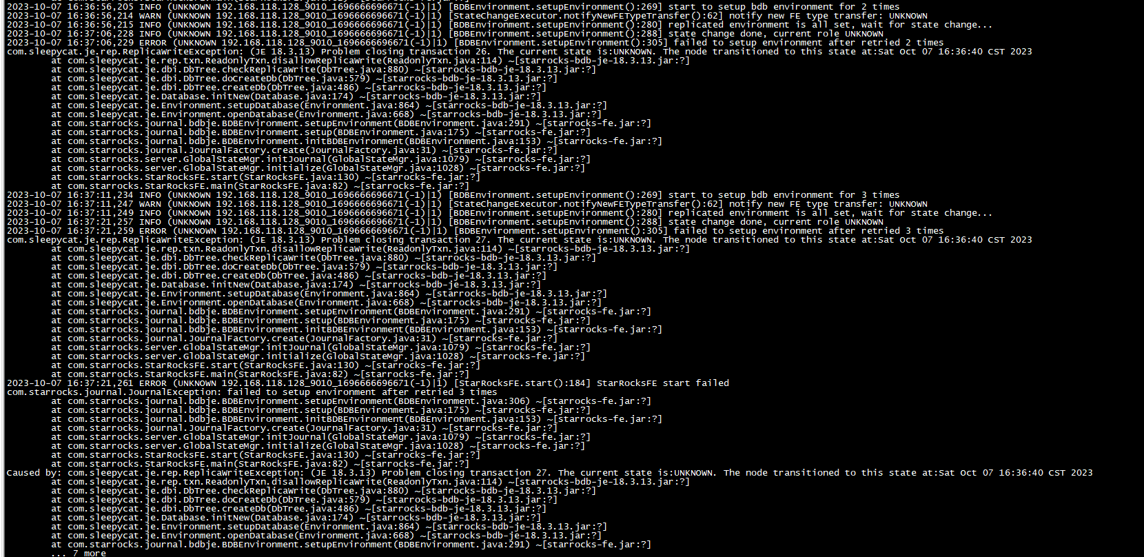

完整的fe.log上传下
2023-10-07 16:50:39,396 INFO (main|1) [StarRocksFE.start():124] StarRocks FE starting, version: 3.0.5-cceec03
2023-10-07 16:50:39,464 INFO (main|1) [FrontendOptions.analyzePriorityCidrs():299] configured prior_cidrs value: 192.168.118.128/24
2023-10-07 16:50:39,476 INFO (main|1) [FrontendOptions.initAddrUseIp():249] Use IP init local addr, IP: /192.168.118.128
2023-10-07 16:50:40,162 INFO (main|1) [Auth.grantRoleInternal():835] grant operator to ‘root’@’%’, isReplay = true
2023-10-07 16:50:40,212 INFO (main|1) [AuthorizationMgr.initBuiltinRoleUnlocked():277] create built-in role root[-1]
2023-10-07 16:50:40,224 INFO (main|1) [AuthorizationMgr.initBuiltinRoleUnlocked():277] create built-in role db_admin[-2]
2023-10-07 16:50:40,227 INFO (main|1) [AuthorizationMgr.initBuiltinRoleUnlocked():277] create built-in role cluster_admin[-3]
2023-10-07 16:50:40,228 INFO (main|1) [AuthorizationMgr.initBuiltinRoleUnlocked():277] create built-in role user_admin[-4]
2023-10-07 16:50:40,229 INFO (main|1) [AuthorizationMgr.initBuiltinRoleUnlocked():277] create built-in role public[-5]
2023-10-07 16:50:40,230 INFO (main|1) [GlobalStateMgr.initAuth():1055] using new privilege framework…
2023-10-07 16:50:40,637 INFO (main|1) [NodeMgr.getHelperNodes():656] get helper nodes: [192.168.118.128:9010]
2023-10-07 16:50:40,667 INFO (main|1) [NodeMgr.getClusterIdAndRoleOnStartup():449] Current run_mode is shared_data
2023-10-07 16:50:40,667 INFO (main|1) [NodeMgr.getClusterIdAndRoleOnStartup():456] Got cluster id: 1674149043, role: FOLLOWER, node name: 192.168.118.128_9010_1696666696671 and run_mode: shared_data
2023-10-07 16:50:40,670 INFO (main|1) [BDBEnvironment.ensureHelperInLocal():340] skip check local environment because helper node and local node are identical.
2023-10-07 16:50:40,727 INFO (main|1) [BDBEnvironment.setupEnvironment():269] start to setup bdb environment for 1 times
2023-10-07 16:50:41,705 WARN (UNKNOWN 192.168.118.128_9010_1696666696671(-1)|1) [StateChangeExecutor.notifyNewFETypeTransfer():62] notify new FE type transfer: UNKNOWN
2023-10-07 16:50:41,777 INFO (UNKNOWN 192.168.118.128_9010_1696666696671(-1)|1) [BDBEnvironment.setupEnvironment():280] replicated environment is all set, wait for state change…
2023-10-07 16:50:51,798 INFO (UNKNOWN 192.168.118.128_9010_1696666696671(-1)|1) [BDBEnvironment.setupEnvironment():288] state change done, current role UNKNOWN
2023-10-07 16:50:51,810 ERROR (UNKNOWN 192.168.118.128_9010_1696666696671(-1)|1) [BDBEnvironment.setupEnvironment():305] failed to setup environment after retried 1 times
com.sleepycat.je.rep.ReplicaWriteException: (JE 18.3.13) Problem closing transaction 25. The current state is:UNKNOWN. The node transitioned to this state at:Sat Oct 07 16:50:41 CST 2023
at com.sleepycat.je.rep.txn.ReadonlyTxn.disallowReplicaWrite(ReadonlyTxn.java:114) ~[starrocks-bdb-je-18.3.13.jar:?]
at com.sleepycat.je.dbi.DbTree.checkReplicaWrite(DbTree.java:880) ~[starrocks-bdb-je-18.3.13.jar:?]
at com.sleepycat.je.dbi.DbTree.doCreateDb(DbTree.java:579) ~[starrocks-bdb-je-18.3.13.jar:?]
at com.sleepycat.je.dbi.DbTree.createDb(DbTree.java:486) ~[starrocks-bdb-je-18.3.13.jar:?]
at com.sleepycat.je.Database.initNew(Database.java:174) ~[starrocks-bdb-je-18.3.13.jar:?]
at com.sleepycat.je.Environment.setupDatabase(Environment.java:864) ~[starrocks-bdb-je-18.3.13.jar:?]
at com.sleepycat.je.Environment.openDatabase(Environment.java:668) ~[starrocks-bdb-je-18.3.13.jar:?]
at com.starrocks.journal.bdbje.BDBEnvironment.setupEnvironment(BDBEnvironment.java:291) ~[starrocks-fe.jar:?]
at com.starrocks.journal.bdbje.BDBEnvironment.setup(BDBEnvironment.java:175) ~[starrocks-fe.jar:?]
at com.starrocks.journal.bdbje.BDBEnvironment.initBDBEnvironment(BDBEnvironment.java:153) ~[starrocks-fe.jar:?]
at com.starrocks.journal.JournalFactory.create(JournalFactory.java:31) ~[starrocks-fe.jar:?]
at com.starrocks.server.GlobalStateMgr.initJournal(GlobalStateMgr.java:1079) ~[starrocks-fe.jar:?]
at com.starrocks.server.GlobalStateMgr.initialize(GlobalStateMgr.java:1028) ~[starrocks-fe.jar:?]
at com.starrocks.StarRocksFE.start(StarRocksFE.java:130) ~[starrocks-fe.jar:?]
at com.starrocks.StarRocksFE.main(StarRocksFE.java:82) ~[starrocks-fe.jar:?]
2023-10-07 16:50:56,840 INFO (UNKNOWN 192.168.118.128_9010_1696666696671(-1)|1) [BDBEnvironment.setupEnvironment():269] start to setup bdb environment for 2 times
2023-10-07 16:50:56,843 WARN (UNKNOWN 192.168.118.128_9010_1696666696671(-1)|1) [StateChangeExecutor.notifyNewFETypeTransfer():62] notify new FE type transfer: UNKNOWN
2023-10-07 16:50:56,845 INFO (UNKNOWN 192.168.118.128_9010_1696666696671(-1)|1) [BDBEnvironment.setupEnvironment():280] replicated environment is all set, wait for state change…
2023-10-07 16:51:06,861 INFO (UNKNOWN 192.168.118.128_9010_1696666696671(-1)|1) [BDBEnvironment.setupEnvironment():288] state change done, current role UNKNOWN
2023-10-07 16:51:06,862 ERROR (UNKNOWN 192.168.118.128_9010_1696666696671(-1)|1) [BDBEnvironment.setupEnvironment():305] failed to setup environment after retried 2 times
com.sleepycat.je.rep.ReplicaWriteException: (JE 18.3.13) Problem closing transaction 26. The current state is:UNKNOWN. The node transitioned to this state at:Sat Oct 07 16:50:41 CST 2023
2023-10-07 16:51:11,865 INFO (UNKNOWN 192.168.118.128_9010_1696666696671(-1)|1) [BDBEnvironment.setupEnvironment():269] start to setup bdb environment for 3 times
2023-10-07 16:51:11,897 WARN (UNKNOWN 192.168.118.128_9010_1696666696671(-1)|1) [StateChangeExecutor.notifyNewFETypeTransfer():62] notify new FE type transfer: UNKNOWN
2023-10-07 16:51:11,899 INFO (UNKNOWN 192.168.118.128_9010_1696666696671(-1)|1) [BDBEnvironment.setupEnvironment():280] replicated environment is all set, wait for state change…
2023-10-07 16:51:21,909 INFO (UNKNOWN 192.168.118.128_9010_1696666696671(-1)|1) [BDBEnvironment.setupEnvironment():288] state change done, current role UNKNOWN
2023-10-07 16:51:21,910 ERROR (UNKNOWN 192.168.118.128_9010_1696666696671(-1)|1) [BDBEnvironment.setupEnvironment():305] failed to setup environment after retried 3 times
com.sleepycat.je.rep.ReplicaWriteException: (JE 18.3.13) Problem closing transaction 27. The current state is:UNKNOWN. The node transitioned to this state at:Sat Oct 07 16:50:41 CST 2023
2023-10-07 16:51:21,912 ERROR (UNKNOWN 192.168.118.128_9010_1696666696671(-1)|1) [StarRocksFE.start():184] StarRocksFE start failed
com.starrocks.journal.JournalException: failed to setup environment after retried 3 times
at com.starrocks.journal.bdbje.BDBEnvironment.setupEnvironment(BDBEnvironment.java:306) ~[starrocks-fe.jar:?]
Caused by: com.sleepycat.je.rep.ReplicaWriteException: (JE 18.3.13) Problem closing transaction 27. The current state is:UNKNOWN. The node transitioned to this state at:Sat Oct 07 16:50:41 CST 2023
… 7 more
