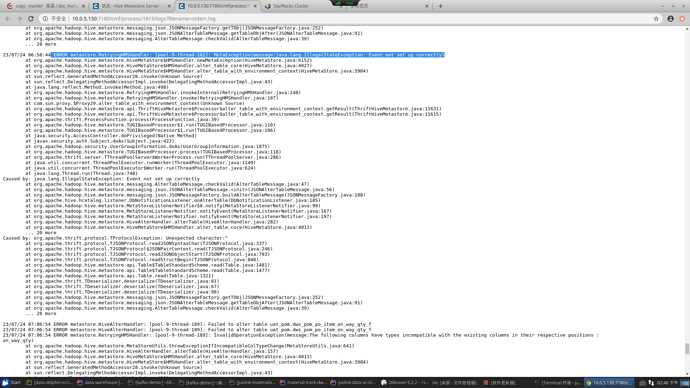

【背景】我们在排查时,发现以下一些异常信息:Hive中日志报出来的:
Caused by: com.starrocks.connector.hive.events.MetastoreNotificationFetchException: Failed to get next notification based on last event id: 2652902, msg: null

2023-07-21 17:01:39,358 ERROR (com.starrocks.connector.hive.events.MetastoreEventsProcessor|30) [HiveMetaClient.callRPC():144] Failed to get next notification based on last event id: 2652902
at com.starrocks.connector.hive.events.MetastoreEventsProcessor.getNextHMSEvents(MetastoreEventsProcessor.java:118) [starrocks-fe.jar:?]
at com.starrocks.connector.hive.events.MetastoreEventsProcessor.getNextHMSEvents(MetastoreEventsProcessor.java:143) [starrocks-fe.jar:?]
at com.starrocks.connector.hive.events.MetastoreEventsProcessor.runAfterCatalogReady(MetastoreEventsProcessor.java:210) [starrocks-fe.jar:?]
2023-07-21 17:01:39,358 ERROR (com.starrocks.connector.hive.events.MetastoreEventsProcessor|30) [HiveMetaClient.callRPC():151] An exception occurred when using the current long link to access metastore. msg: Failed to get next notification based on last event id: 2652902
2023-07-21 17:01:39,359 INFO (com.starrocks.connector.hive.events.MetastoreEventsProcessor|30) [HiveMetaStoreThriftClient.close():575] Closed a connection to metastore, current connections: 1
2023-07-21 17:01:39,359 ERROR (com.starrocks.connector.hive.events.MetastoreEventsProcessor|30) [HiveMetastore.getNextEventResponse():177] Unable to fetch notifications from metastore. Last synced event id is 2652902
