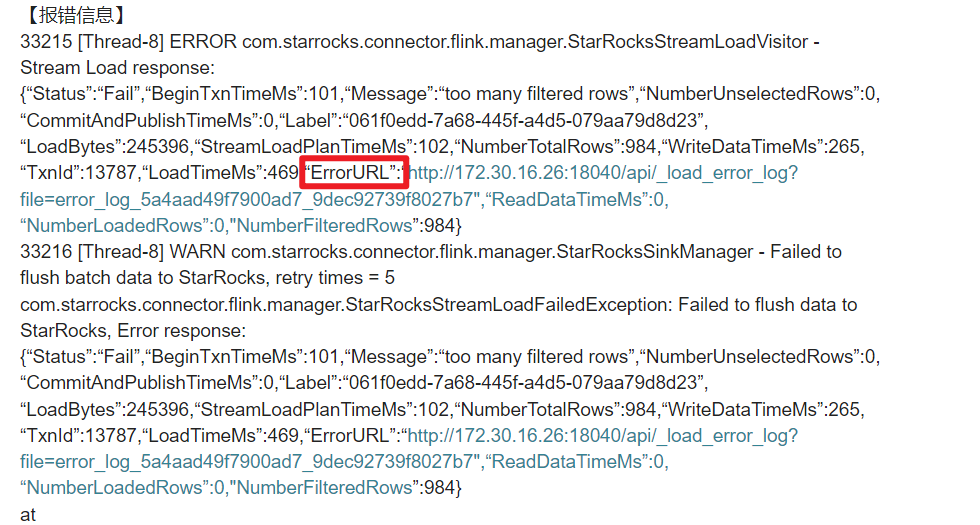

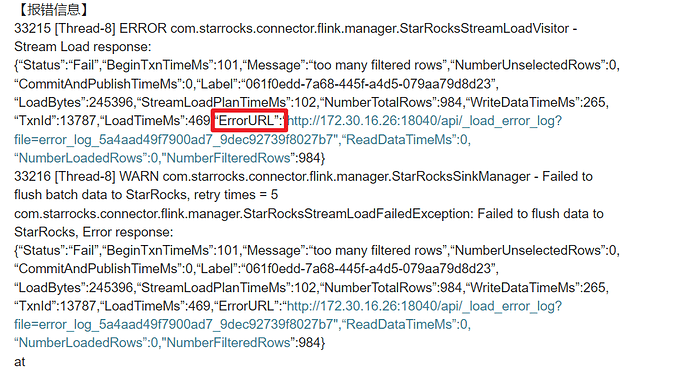

【报错信息】
33215 [Thread-8] ERROR com.starrocks.connector.flink.manager.StarRocksStreamLoadVisitor - Stream Load response:
{“Status”:“Fail”,“BeginTxnTimeMs”:101,“Message”:“too many filtered rows”,“NumberUnselectedRows”:0,“CommitAndPublishTimeMs”:0,“Label”:“061f0edd-7a68-445f-a4d5-079aa79d8d23”,“LoadBytes”:245396,“StreamLoadPlanTimeMs”:102,“NumberTotalRows”:984,“WriteDataTimeMs”:265,“TxnId”:13787,“LoadTimeMs”:469,“ErrorURL”:“http://172.30.16.26:18040/api/_load_error_log?file=error_log_5a4aad49f7900ad7_9dec92739f8027b7",“ReadDataTimeMs”:0,“NumberLoadedRows”:0,"NumberFilteredRows”:984}
33216 [Thread-8] WARN com.starrocks.connector.flink.manager.StarRocksSinkManager - Failed to flush batch data to StarRocks, retry times = 5
com.starrocks.connector.flink.manager.StarRocksStreamLoadFailedException: Failed to flush data to StarRocks, Error response:
at com.starrocks.connector.flink.manager.StarRocksStreamLoadVisitor.doStreamLoad(StarRocksStreamLoadVisitor.java:89)
at com.starrocks.connector.flink.manager.StarRocksSinkManager.asyncFlush(StarRocksSinkManager.java:258)
at com.starrocks.connector.flink.manager.StarRocksSinkManager.access$000(StarRocksSinkManager.java:52)
at com.starrocks.connector.flink.manager.StarRocksSinkManager$1.run(StarRocksSinkManager.java:120)
at java.lang.Thread.run(Thread.java:748)
