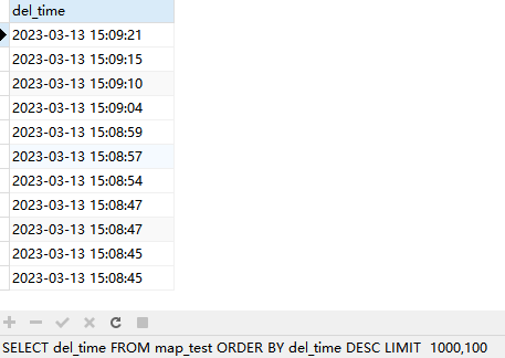

查询分页数据时,发现同样页数数据不一致。
执行以下SQL,多次结果不一致:

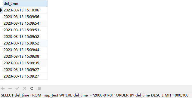

SELECT del_time FROM map_test ORDER BY del_time DESC LIMIT 1000,100
如果加上限定条件,即使条件没有过滤任何数据,结果保持一致:
SELECT del_time FROM map_test WHERE del_time > ‘2000-01-01’ ORDER BY del_time DESC LIMIT 1000,100
修正一下,在做千万级别测试时,发现:
SELECT del_time FROM map_test WHERE date> ‘2000-01-01’ ORDER BY del_time DESC LIMIT 1000,100
这种类型查询,也会出现不一致的情况!

- ShortKeyFilterRows: 0
- ZoneMapIndexFilterRows: 0
- SegmentRead: 3.149ms
- __MAX_OF_SegmentRead: 49.358ms
- __MIN_OF_SegmentRead: 0ns
- BlockFetch: 2.190ms
- __MAX_OF_BlockFetch: 32.254ms
- __MIN_OF_BlockFetch: 0ns
- BlockFetchCount: 1.065K (1065)
- __MAX_OF_BlockFetchCount: 51
- __MIN_OF_BlockFetchCount: 0
- BlockSeek: 948.812us
- __MAX_OF_BlockSeek: 25.668ms
- __MIN_OF_BlockSeek: 0ns
- BlockSeekCount: 546
- __MAX_OF_BlockSeekCount: 26
- __MIN_OF_BlockSeekCount: 0
- ChunkCopy: 0ns
- DecompressT: 104.963us
- DelVecFilterRows: 0
- IndexLoad: 0ns
- PredFilter: 0ns
- PredFilterRows: 0
- RowsetsReadCount: 120
- SegmentsReadCount: 56
- __MAX_OF_SegmentsReadCount: 1
- __MIN_OF_SegmentsReadCount: 0
- TotalColumnsDataPageCount: 546
- __MAX_OF_TotalColumnsDataPageCount: 26
- __MIN_OF_TotalColumnsDataPageCount: 0
- SubmitIOTaskCount: 120
- TabletCount: 120
- UncompressedBytesRead: 20.16 MB
- __MAX_OF_UncompressedBytesRead: 991.48 KB
- __MIN_OF_UncompressedBytesRead: 0.00
Pipeline (id=0):
- ActiveTime: 39.567us
- BlockByInputEmpty: 0
- BlockByOutputFull: 0
- BlockByPrecondition: 0
- DegreeOfParallelism: 1
- DriverTotalTime: 2.454ms
- OverheadTime: 39.567us
- PendingTime: 0ns
- InputEmptyTime: 0ns
- FirstInputEmptyTime: 0ns
- FollowupInputEmptyTime: 0ns
- OutputFullTime: 0ns
- PendingFinishTime: 0ns
- PreconditionBlockTime: 0ns
- ScheduleCount: 3
- ScheduleTime: 2.414ms
- TotalDegreeOfParallelism: 3
- YieldByTimeLimit: 0
NOOP_SINK (plan_node_id=0):
CommonMetrics:
- CloseTime: 695ns
- OperatorTotalTime: 1.31us
- PeakMemoryUsage: 0.00
- PrepareTime: 27.574us
- PullChunkNum: 0
- PullRowNum: 0
- PullTotalTime: 0ns
- PushChunkNum: 0
- PushRowNum: 0
- PushTotalTime: 0ns
- SetFinishedTime: 63ns
- SetFinishingTime: 272ns
UniqueMetrics:
OLAP_SCAN_PREPARE (plan_node_id=0):
CommonMetrics:
- CloseTime: 32.424us
- OperatorTotalTime: 58.378us
- PrepareTime: 231.844us
- PullChunkNum: 3
- PullRowNum: 0
- PullTotalTime: 25.290us
- PushChunkNum: 0
- PushRowNum: 0
- SetFinishedTime: 155ns
- SetFinishingTime: 508ns
UniqueMetrics:
这个最新的分支有pr合入修复了相关的问题,详请关注版本的更新,下个小版本升级验证下。
