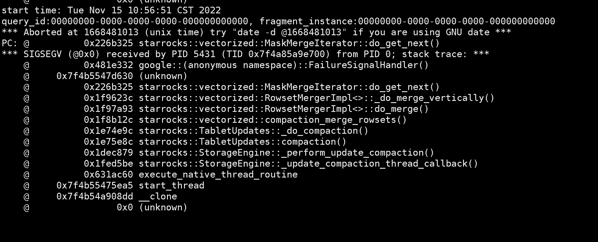

    • be.out
      start time: Tue Nov 15 10:56:51 CST 2022
      *** Aborted at 1668481013 (unix time) try “date -d @1668481013” if you are using GNU date ***
      PC: @ 0x226b325 starrocks::vectorized::MaskMergeIterator::do_get_next()
      *** SIGSEGV (@0x0) received by PID 5431 (TID 0x7f4a85a9e700) from PID 0; stack trace: ***
      @ 0x481e332 google::(anonymous namespace)::FailureSignalHandler()
      @ 0x7f4b5547d630 (unknown)
      @ 0x1f9623c starrocks::vectorized::RowsetMergerImpl<>::_do_merge_vertically()
      @ 0x1f97a93 starrocks::vectorized::RowsetMergerImpl<>::do_merge()
      @ 0x1f8b12c starrocks::vectorized::compaction_merge_rowsets()
      @ 0x1e74e9c starrocks::TabletUpdates::_do_compaction()
      @ 0x1e75e8c starrocks::TabletUpdates::compaction()
      @ 0x1dec879 starrocks::StorageEngine::_perform_update_compaction()
      @ 0x1fed5be starrocks::StorageEngine::_update_compaction_thread_callback()
      @ 0x631ac60 execute_native_thread_routine
      @ 0x7f4b55475ea5 start_thread
      @ 0x7f4b54a908dd __clone
      @ 0x0 (unknown)
表是什么模型?core文件方便的话也上传下看看,3个be的be.out文件内容是一样的吗?
表有三张,一张unique,两张PRIMARY,同时导入,可以发core的,be.out都一样的
core传不了,太大了,怎么给你
谁能帮忙看看啊,集群起不来,瘫痪着呢,急啊
升级到2.4.1 或是临是修改be.conf vertical_compaction_max_columns_per_group=1000
等升级后,再去掉这个配置试试
2.4.1已发布,直接升级到2.4.1就行
http://cdn-release.starrocks.com/StarRocks-2.4.1.tar.gz?Expires=1669708222&OSSAccessKeyId=LTAI4GFYjbX9e7QmFnAAvkt8&Signature=CK0%2BSR%2FcDcxN8UvLkdRIdxTY7Us%3D
:pray: :pray: :pray:
感谢哈,我升级一下试试
升级后,还有问题吗?
暂时没有发现问题,谢谢啦
