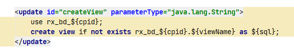

【详述】
1. jdbc url里面增加&allowMultiQueries=true配置
2. mapper方法里执行任意多条sql,发现sr里面sql是提交执行了(视图已经创建了),但是mapper方法却报异常。
异常信息如下:
org.springframework.dao.TransientDataAccessResourceException:
Error updating database. Cause: java.sql.SQLException
The error may exist in file [D:\工作\weile code\olap\olap-admin\target\classes\mapper\SqlQueryMapper.xml]
The error may involve com.ruixue.olap.mapper.SqlQueryMapper.createView-Inline
The error occurred while setting parameters
SQL: use rx_bd_example_db; create view if not exists rx_bd_example_db.tmp_sql_query_1665650994806 as SELECT #distinct_id,#time,current_energy,cast( ‘true’ AS boolean ) AS boo4,[ ‘1’, ‘2’, ‘3’ ] AS arr5 FROM dwd_fact_event_mewcoinget_999 LIMIT 3000;
; null; nested exception is java.sql.SQLException
