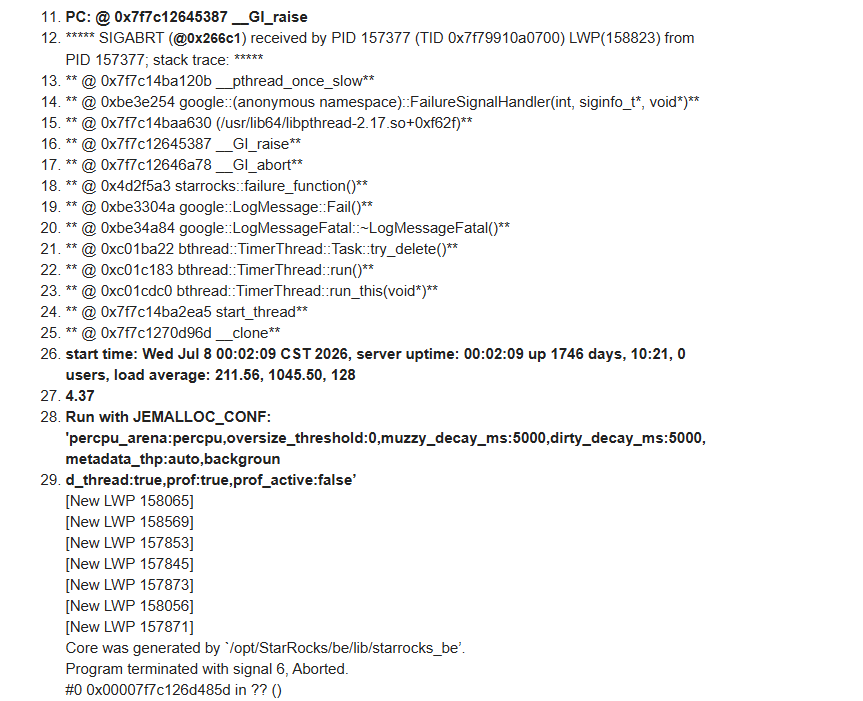

  • be.out
  1. start time: Wed Mar 11 13:53:38 CST 2026, server uptime: 13:53:38 up 1628 days, 12 min, 1 user, load average: 0.08, 0.15, 0.10
  2. Run with JEMALLOC_CONF: 'percpu_arena:percpu,oversize_threshold:0,muzzy_decay_ms:5000,dirty_decay_ms:5000,metadata_thp:auto,backgroun
  3. d_thread:true,prof:true,prof_active:false’
  4. F20260707 23:17:43.121201 140160101123840 timer_thread.cpp:303] Check failed: version.load(butil::memory_order_relaxed) == id_version
  5. ** + 2 (2 vs. 5) **
  6. 3.5.13 RELEASE (build dca7c0a distro centos arch x86_64)
  7. query_id:00000000-0000-0000-0000-000000000000, fragment_instance:00000000-0000-0000-0000-000000000000, plan_node_id:-1
  8. [1783437463.126][thread: 140160101123840] je_mallctl execute purge success
  9. [1783437463.126][thread: 140160101123840] je_mallctl execute dontdump success
  10. ***** Aborted at 1783437472 (unix time) try “date -d @1783437472” if you are using GNU date *****
  11. PC: @ 0x7f7c12645387 __GI_raise
  12. ***** SIGABRT (@0x266c1) received by PID 157377 (TID 0x7f79910a0700) LWP(158823) from PID 157377; stack trace: *****
  13. ** @ 0x7f7c14ba120b __pthread_once_slow**
  14. ** @ 0xbe3e254 google::(anonymous namespace)::FailureSignalHandler(int, siginfo_t*, void*)**
  15. ** @ 0x7f7c14baa630 (/usr/lib64/libpthread-2.17.so+0xf62f)**
  16. ** @ 0x7f7c12645387 __GI_raise**
  17. ** @ 0x7f7c12646a78 __GI_abort**
  18. ** @ 0x4d2f5a3 starrocks::failure_function()**
  19. ** @ 0xbe3304a google::LogMessage::Fail()**
  20. ** @ 0xbe34a84 google::LogMessageFatal::~LogMessageFatal()**
  21. ** @ 0xc01ba22 bthread::TimerThread::Task::try_delete()**
  22. ** @ 0xc01c183 bthread::TimerThread::run()**
  23. ** @ 0xc01cdc0 bthread::TimerThread::run_this(void*)**
  24. ** @ 0x7f7c14ba2ea5 start_thread**
  25. ** @ 0x7f7c1270d96d __clone**
  26. start time: Wed Jul 8 00:02:09 CST 2026, server uptime: 00:02:09 up 1746 days, 10:21, 0 users, load average: 211.56, 1045.50, 128
  27. 4.37
  28. Run with JEMALLOC_CONF: 'percpu_arena:percpu,oversize_threshold:0,muzzy_decay_ms:5000,dirty_decay_ms:5000,metadata_thp:auto,backgroun
  29. d_thread:true,prof:true,prof_active:false’
    [New LWP 158065]
    [New LWP 158569]
    [New LWP 157853]
    [New LWP 157845]
    [New LWP 157873]
    [New LWP 158056]
    [New LWP 157871]
    Core was generated by `/opt/StarRocks/be/lib/starrocks_be’.
    Program terminated with signal 6, Aborted.
    #0 0x00007f7c126d485d in ?? ()

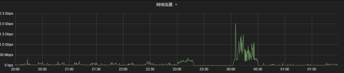

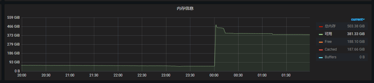

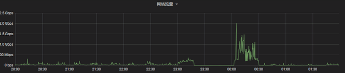

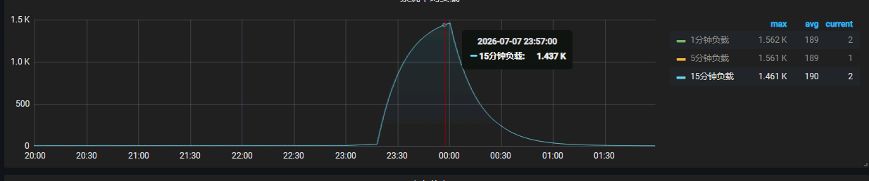

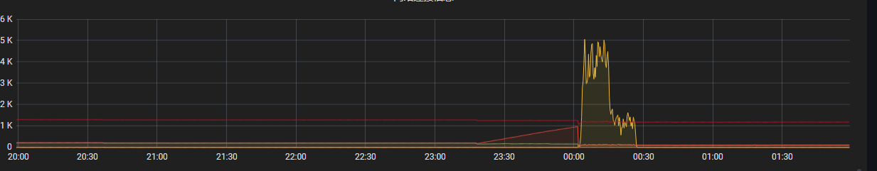

系统负载指标情况:
