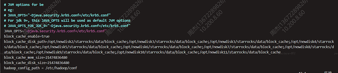

fe.conf
be.conf

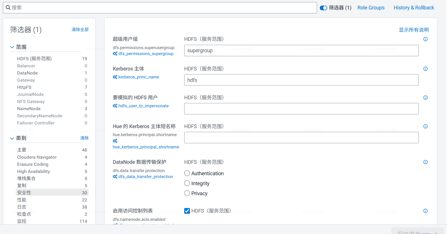

这个看着就是HDFS的权限问题,是不是hive的文件权限不对,hdfs dfs -ls /user/hive/warehouse(一般情况是这个路径,具体看你hive配置),用户和你starrocks配置的hadoop user是不是一样
[root@master ~]# hdfs dfs -ls hdfs://nameservice1/user/hive/warehouse/test_db/test_data_partitioned/create_date=2025-01-07/
Found 4 items
-rw-rw-rw-   3 hive hive      40427 2026-03-05 11:11 hdfs://nameservice1/user/hive/warehouse/test_db/test_data_partitioned/create_date=2025-01-07/000000_0
-rw-rw-rw-   3 hive hive      45905 2026-03-05 11:11 hdfs://nameservice1/user/hive/warehouse/test_db/test_data_partitioned/create_date=2025-01-07/000001_0
-rw-rw-rw-   3 hive hive      42421 2026-03-05 11:11 hdfs://nameservice1/user/hive/warehouse/test_db/test_data_partitioned/create_date=2025-01-07/000002_0
-rw-rw-rw-   3 hive hive      44087 2026-03-05 11:11 hdfs://nameservice1/user/hive/warehouse/test_db/test_data_partitioned/create_date=2025-01-07/000003_0
[root@master ~]#
这个是hive catalog的创建语句
| hive12 | CREATE EXTERNAL CATALOG hive12
PROPERTIES (“dfs.ha.namenodes.nameservice1” = “namenode139,namenode233”,
“hadoop.security.authentication” = “kerberos”,
“dfs.namenode.rpc-address.nameservice1.namenode139” = “cdh7:8020”,
“hadoop.kerberos.keytab” = “/home/bsmp/portal/.keytab/hive.keytab”,
“dfs.namenode.rpc-address.nameservice1.namenode233” = “cdh8:8020”,
“hadoop.kerberos.principal” = “hive/admin@AOTAIN.COM”,
“hive.metastore.uris” = “thrift://cdh5:9083”,
“type” = “hive”,
“dfs.nameservices” = “nameservice1”,
“dfs.client.failover.proxy.provider.nameservice1” = “org.apache.hadoop.hdfs.server.namenode.ha.ConfiguredFailoverProxyProvider”,
“java.security.krb5.conf” = “/etc/krb5.conf”
