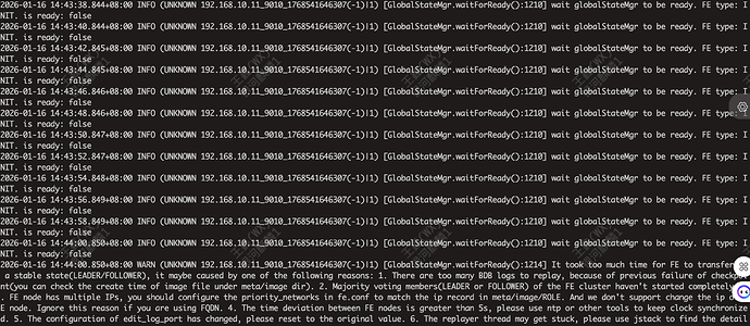

  • 三台fe.log中反复报
    我查看其中提示信息,在我这里都不存在,时间是同步的:
    It took too much time for FE to transfer to a stable state(LEADER/FOLLOWER), it maybe caused by one of the following reasons:
    1. There are too many BDB logs to replay, because of previous failure of checkpoint(you can check the create time of image file under meta/image dir).
    2. Majority voting members(LEADER or FOLLOWER) of the FE cluster haven’t started completely.
    3. FE node has multiple IPs, you should configure the priority_networks in fe.conf to match the ip record in meta/image/ROLE. And we don’t support change the ip of FE node. Ignore this reason if you are using FQDN.
    4. The time deviation between FE nodes is greater than 5s, please use ntp or other tools to keep clock synchronized.
    5. The configuration of edit_log_port has changed, please reset to the original value.
    6. The replayer thread may get stuck, please use jstack to find the details.
各位大佬请帮忙看看,谢谢,相关日志如下admin-3.zip (63.8 KB)

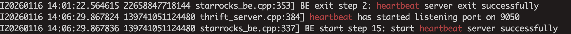

BE都是启动成功的
集群第一次启动时,第一个启动的FE为11,其它2个启动方式依照官网start_fe.sh --helper 192.168.10.11:9010 --daemon;reboot虚拟机启动时就没加–helper了
已解决,还是priority_networks 的问题,将每台的${本地虚拟机IP} 改为 192.168.10.0/24 即可,但启动的时间还是有点长
