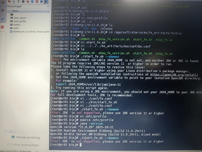

对国产bisheng jdk不支持解决
【详述】本地安装的是bisheng jdk 11,在安装starrocks3.4.7启动fe时碰到无法识别jdk的问题,请问这块有解决的方案吗

set the JAVA_HOME to a correct location and then run $JAVA_HOME/bin/java -Xms32M -Xmx32M -version
paste the output here.
It must be JDK, not JRE, try to download the JDK and set correct JAVA_HOME.
Thank you for your response. That is indeed the root cause.
