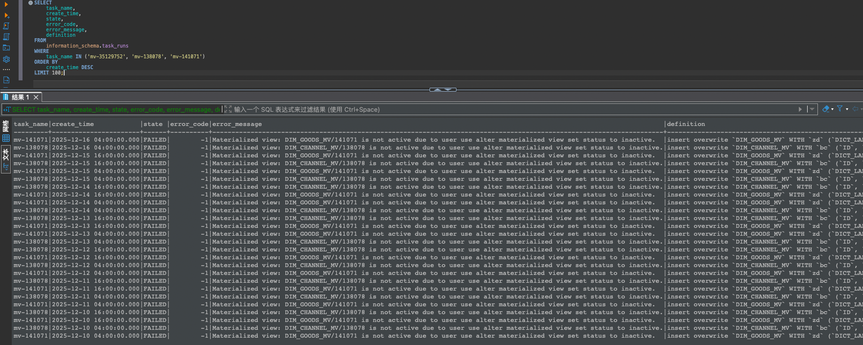

从日志中观察到以下任务频繁初始化:
2025-12-15 00:52:55.054+08:00 INFO (leaderCheckpointer|204) [TaskRun.initStatus():365] init task status, task:mv-35129752, query_id:b45c0f79-ae64-11f0-931f-00505691212e, create_time:1761040799438
2025-12-15 00:52:55.054+08:00 INFO (leaderCheckpointer|204) [TaskRun.initStatus():365] init task status, task:mv-35129752, query_id:b45c84ae-ae64-11f0-931f-00505691212e, create_time:1761040799441
2025-12-15 04:50:06.974+08:00 INFO (leaderCheckpointer|204) [TaskRun.initStatus():365] init task status, task:mv-35129752, ...
2025-12-15 07:28:18.632+08:00 INFO (leaderCheckpointer|204) [TaskRun.initStatus():365] init task status, task:mv-35129752, ...
关键发现:
  • mv-35129752 任务在日志中反复初始化,但在当前 SHOW MATERIALIZED VIEWS 查询结果中不存在
  • 该任务疑似为"孤儿任务"(MV 已被删除或迁移,但 TaskRun 元数据残留)
  • 其他相关任务:mv-138078 (DIM_CHANNEL_MV), mv-141071 (DIM_GOODS_MV)fe.warn.log.20251215-1 (22.1 MB)
