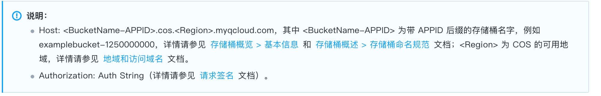

按照腾讯云文档 https://cloud.tencent.com/document/product/436/8289 的说明
正确的应该是
POST https://COSID.cos.ap-guangzhou.myqcloud.com/?delete
请求体
<Delete xmlns=""http://s3.amazonaws.com/doc/2006-03-01/"">
    <Object>
        <Key>starrocks/shared/0f2e43f6-d928-4841-9f9a-69720d985cc0/db13007/13122/13124/data/0000000000000006_ab37348b-c7d4-403d-b101-7ff65f95f273.dat</Key>
    </Object>
    <Quiet>true</Quiet>
</Delete>
starrocks作为存储桶根目录,不应该在url中出现,应该在请求体中完整的显示要删除文件的key;

大佬,COS不再支持path-style格式
https://cloud.tencent.com/document/product/436/96243
