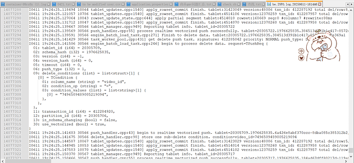

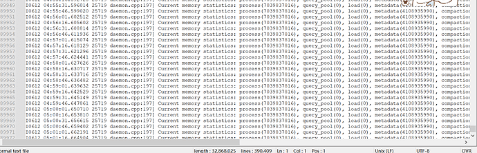

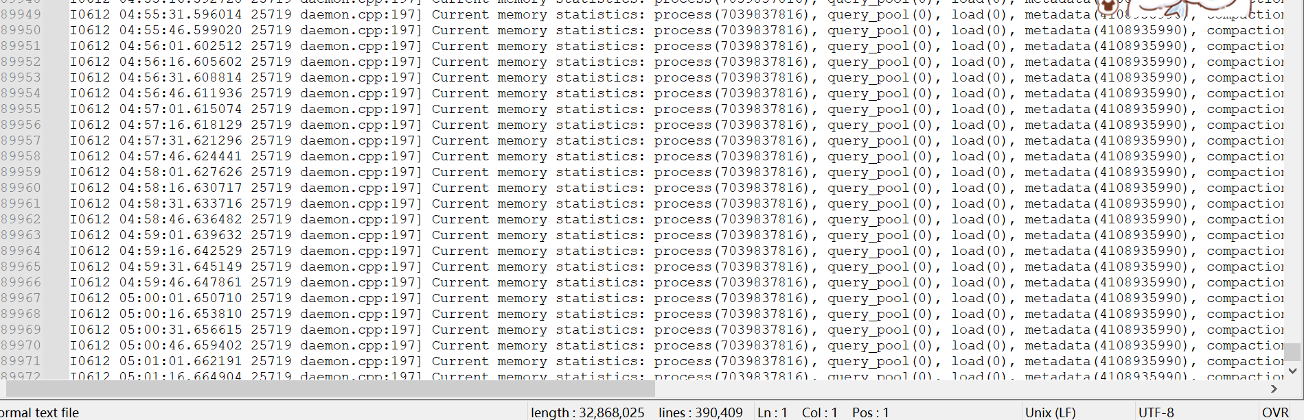

集群中的有台be的宕机了,启动之后be.INFO一直打印日志,但是alive一直是false
【详述】集群中有台be宕机了,重启之后日志一直打印“Current memory statistics: process(7039837816), query_pool(0), load(0), metadata(4108935990), compaction(0), schema_change(0), column_pool(0), page_cache(43328), update(681799540), chunk_allocator(8208), clone(0), consistency(0), datacache(0)”,SHOW PROC ‘/backends’;命令之后alive一直是false
【背景】查询写数据
【业务影响】影响写入
【是否存算分离】 否
【StarRocks版本】例如:1.18.2
【集群规模】3fe(1 follower+2observer)+4be
【机器信息】
【联系方式】15026796346@163.com
链接: https://pan.baidu.com/s/11m8nYloBTVIlkgqUjPyyMw 提取码: 1144
最后就一直这样了

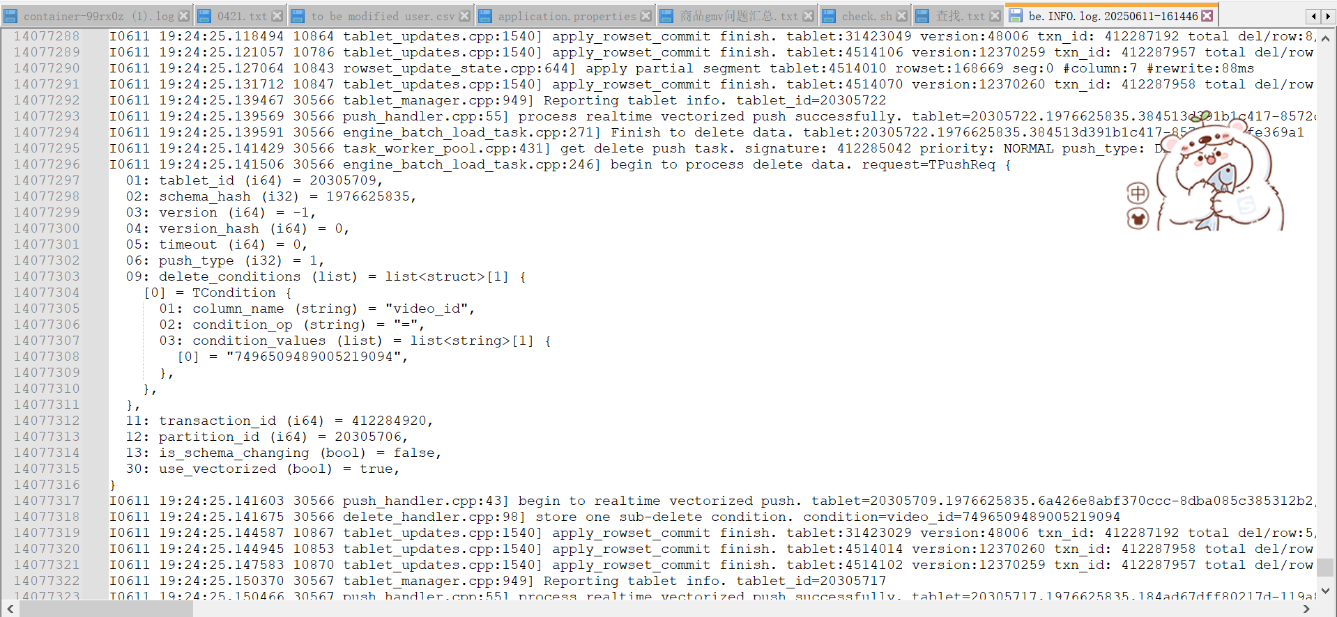

BE重启后的完整日志发一下.
再次重启BE, 也不能恢复?

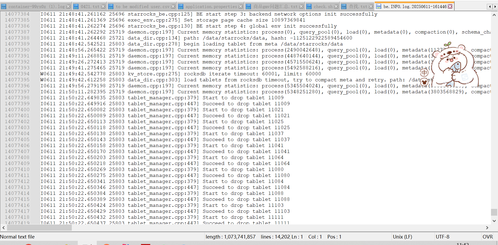

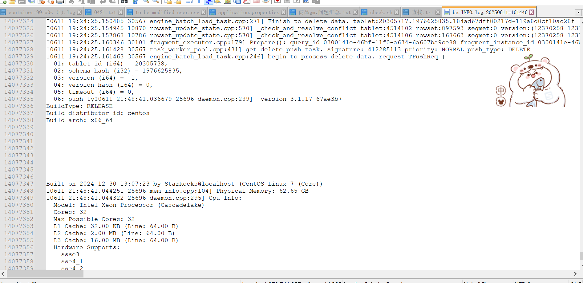

在这个帖子里的百度云里,重启之后 ps查看进程是在的,但是一直打印那个log日志,然后几个端口都不通

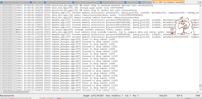

$ grep starrocks_be.cpp be.INFO.log.20250611-161446
I0611 21:48:41.260057 25696 starrocks_be.cpp:115] BE start step 1: daemon threads start successfully
I0611 21:48:41.260151 25696 starrocks_be.cpp:119] BE start step 2: jdbc driver manager init successfully
I0611 21:48:41.261162 25696 starrocks_be.cpp:125] BE start step 3: backend network options init successfully
I0611 21:48:41.262274 25696 starrocks_be.cpp:130] BE start step 4: global env init successfully
The BE process failed to load the tablet meta from rocksdb
something wrong with the local rocksdb meta store. Either drop the entire data from the /data/starrocks/data, let starrocks to repair the tablet replicas or wait until the tablets are loaded successful.
