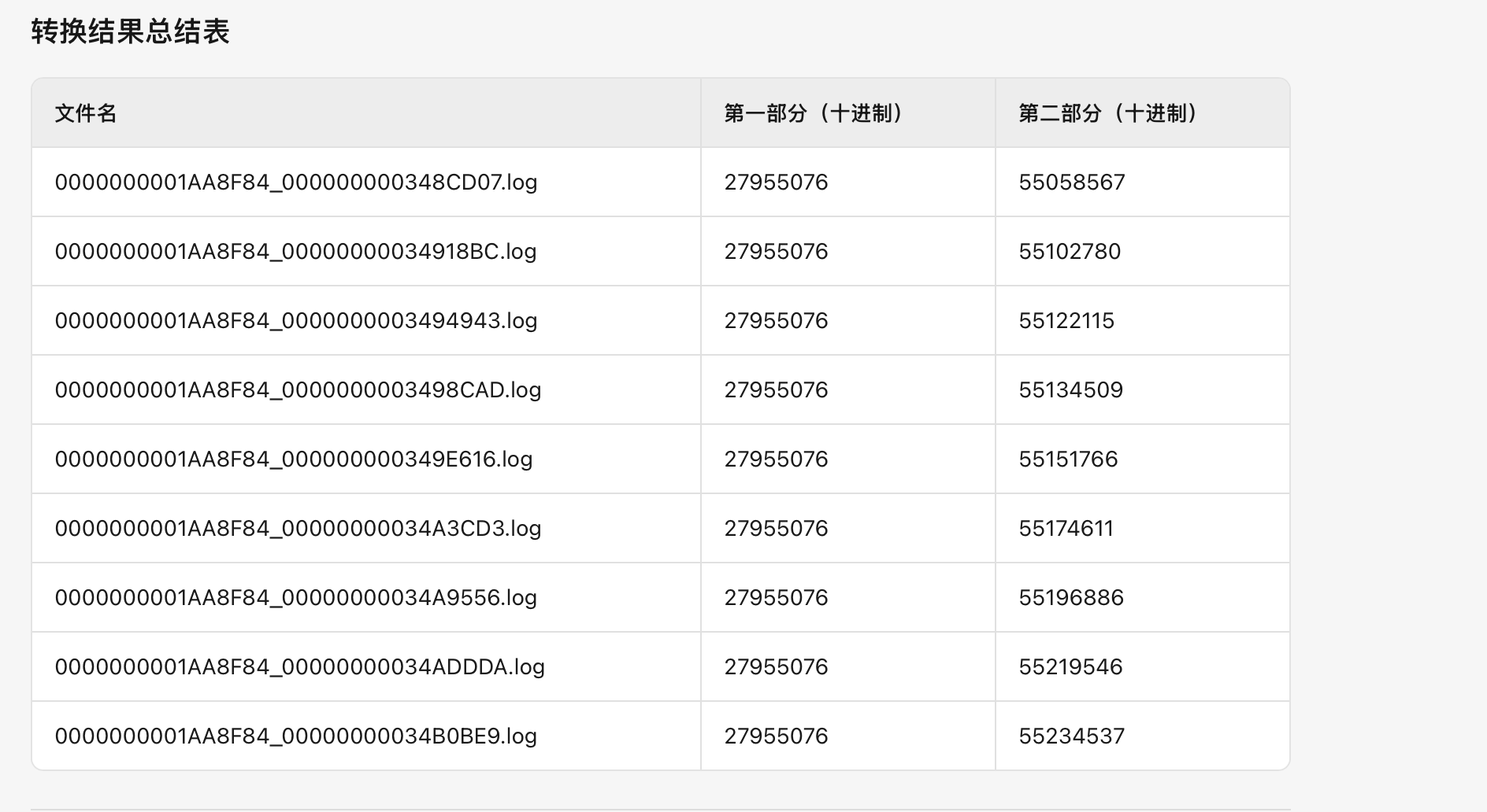

select *
from information_schema.partitions_meta
where partition_id=7955075 通 分区ID查询到对应的表和文件位置
和日志的不一样。55058500, 55102727, 55122108, 55134531, 55151789, 55174678, 55196883, 55219542, 55238106, 55249897
