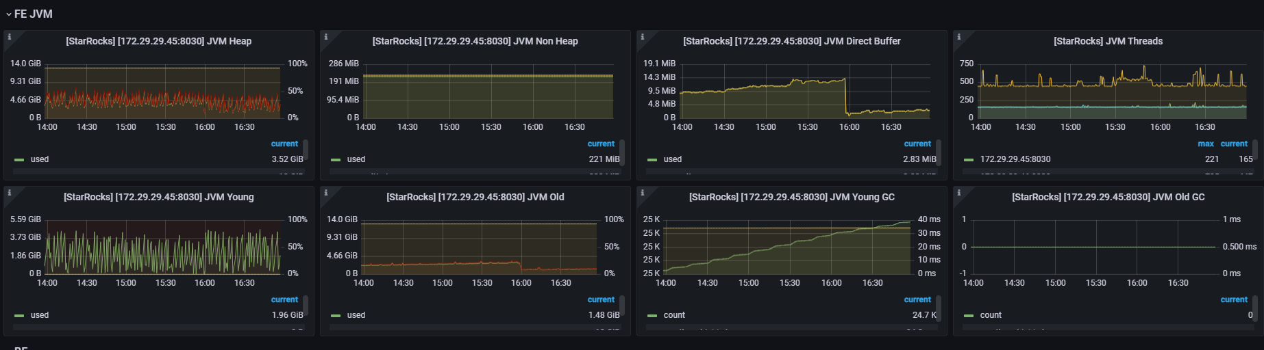

fe lead节点日志
fe_lead.log.tar.gz (33.3 MB)
fe lead节点gc日志
fe.gc.log.tar.gz (733.4 KB)
