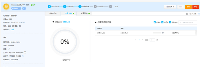

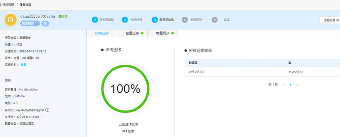

CloudCanal数据导入表结构同步成功,数据没有同步
【详述】CloudCanal数据导入表结构同步成功,但是数据没有同步,就像是卡住了一样。日志没有报错
【背景】CloudCanal增量数据同步

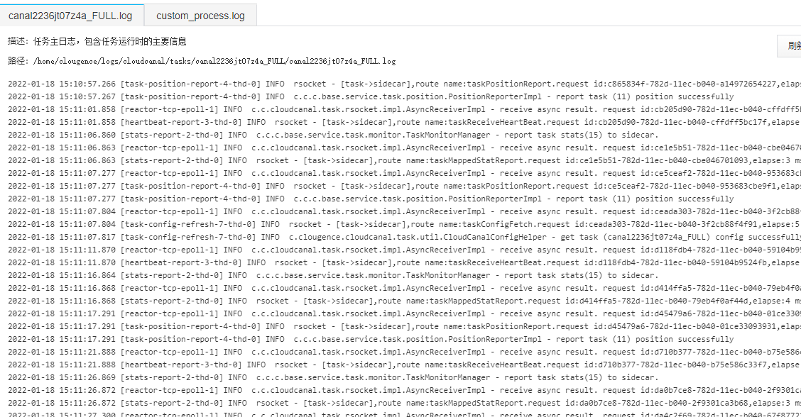

部分日志:
2022-01-18 15:10:57.266 [task-position-report-4-thd-0] INFO rsocket - [task->sidecar],route name:taskPositionReport.request id:c865834f-782d-11ec-b040-a14972654227,elapse:6 ms.
2022-01-18 15:10:57.267 [task-position-report-4-thd-0] INFO c.c.c.base.service.task.position.PositionReporterImpl - report task (11) position successfully
2022-01-18 15:11:01.858 [reactor-tcp-epoll-1] INFO c.c.cloudcanal.task.rsocket.impl.AsyncReceiverImpl - receive async result. request id:cb205d90-782d-11ec-b040-cffdff5bc17f
2022-01-18 15:11:01.858 [heartbeat-report-3-thd-0] INFO rsocket - [task->sidecar],route name:taskReceiveHeartBeat.request id:cb205d90-782d-11ec-b040-cffdff5bc17f,elapse:18 ms.
2022-01-18 15:11:06.860 [stats-report-2-thd-0] INFO c.c.c.base.service.task.monitor.TaskMonitorManager - report task stats(15) to sidecar.
2022-01-18 15:11:06.863 [reactor-tcp-epoll-1] INFO c.c.cloudcanal.task.rsocket.impl.AsyncReceiverImpl - receive async result. request id:ce1e5b51-782d-11ec-b040-cbe046701093
2022-01-18 15:11:06.863 [stats-report-2-thd-0] INFO rsocket - [task->sidecar],route name:taskMappedStatReport.request id:ce1e5b51-782d-11ec-b040-cbe046701093,elapse:3 ms.
2022-01-18 15:11:07.277 [reactor-tcp-epoll-1] INFO c.c.cloudcanal.task.rsocket.impl.AsyncReceiverImpl - receive async result. request id:ce5ceaf2-782d-11ec-b040-953683cbe9f1
2022-01-18 15:11:07.277 [task-position-report-4-thd-0] INFO rsocket - [task->sidecar],route name:taskPositionReport.request id:ce5ceaf2-782d-11ec-b040-953683cbe9f1,elapse:7 ms.
2022-01-18 15:11:07.277 [task-position-report-4-thd-0] INFO c.c.c.base.service.task.position.PositionReporterImpl - report task (11) position successfully
2022-01-18 15:11:07.804 [reactor-tcp-epoll-1] INFO c.c.cloudcanal.task.rsocket.impl.AsyncReceiverImpl - receive async result. request id:ceada303-782d-11ec-b040-3f2cb88f4f91
2022-01-18 15:11:07.804 [task-config-refresh-7-thd-0] INFO rsocket - [task->sidecar],route name:taskConfigFetch.request id:ceada303-782d-11ec-b040-3f2cb88f4f91,elapse:5 ms.
2022-01-18 15:11:07.817 [task-config-refresh-7-thd-0] INFO c.clougence.cloudcanal.task.util.CloudCanalConfigHelper - get task (canal2236jt07z4a_FULL) config successfully.
2022-01-18 15:11:11.870 [reactor-tcp-epoll-1] INFO c.c.cloudcanal.task.rsocket.impl.AsyncReceiverImpl - receive async result. request id:d118fdb4-782d-11ec-b040-59104b9524fb
2022-01-18 15:11:11.870 [heartbeat-report-3-thd-0] INFO rsocket - [task->sidecar],route name:taskReceiveHeartBeat.request id:d118fdb4-782d-11ec-b040-59104b9524fb,elapse:12 ms.
2022-01-18 15:11:16.864 [stats-report-2-thd-0] INFO c.c.c.base.service.task.monitor.TaskMonitorManager - report task stats(15) to sidecar.

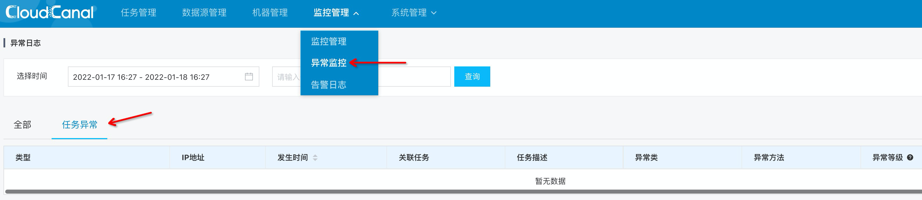

@U_1638258806011_0925 您好,看你的截图是完成结构迁移后,全量阶段没有正常启动。可以按照如下方式看下异常监控日志,有没有产生一些异常信息?

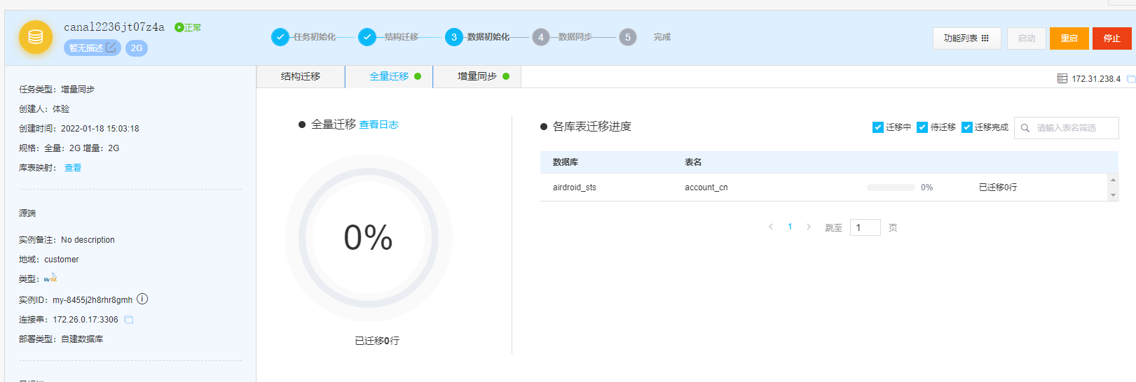

我按这篇文章改了参数,还改了,fe.conf配置(不过我不知道有没生效,没地方看),还是同样问题。
值改的多大?任务规格有4G的话,可以改4K试试,另外有个停顿时间也可以控制。还有问题的话可以加下我微caizi19900527 帮你再确认下
