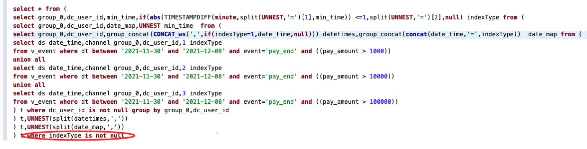

版本:1.19.3
当前SQL
执行下面SQL时,不加红框处执行正常,加上红框处条件就报unknown error 。
fe.log报错信息如下:

select * from (
select group_0,dc_user_id,min_time, abs (minutes_diff(split( UNNEST ,’=’)[1],min_time)), if ( abs (minutes_diff(split( UNNEST ,’=’)[1],min_time)) <=1,split( UNNEST ,’=’)[2], null ) indexType from (
select group_0,dc_user_id,date_map, UNNEST min_time from (
select group_0,dc_user_id,group_concat( CONCAT_ws (’,’, if (indexType=1,date_time, null ))) datetimes,group_concat( concat (date_time,’=’,indexType)) date_map from (
select ds date_time,channel group_0,dc_user_id,1 indexType
from v_event where dt between ‘2021-11-30’ and ‘2021-12-08’ and event=‘pay_end’ and ((pay_amount > 1000))
union all
select ds date_time,channel group_0,dc_user_id,2 indexType
from v_event where dt between ‘2021-11-30’ and ‘2021-12-08’ and event=‘pay_end’ and ((pay_amount > 10000))
union all
select ds date_time,channel group_0,dc_user_id,3 indexType
from v_event where dt between ‘2021-11-30’ and ‘2021-12-08’ and event=‘pay_end’ and ((pay_amount > 100000))
) t where dc_user_id is not null group by group_0,dc_user_id
) t, UNNEST (split(datetimes,’,’))
) t, UNNEST (split(date_map,’,’))
) t where indexType is not null
